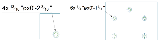

A new checkbox for automatic leader line position was added on the bolt label dialog and label arrows will point towards the bolt center.
If the box for "Automatic leader line position for labels on hole or bolt patterns" is checked, when the label is moved, the arrowhead repositions to the closest bolt in the bolt pattern to match the line orientation. If the box is unchecked, the arrowhead will remain on the same bolt from the pattern, no matter where the label is moved. In this case, the label arrowhead can be manually moved to another bolt from the pattern by using the grip point.
| Box checked | Box unchecked |
The label arrowhead for manual or automatic bolt labels will be placed on the contour of the bolt, and it will always point towards the center of the bolt.
