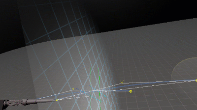

A white translucent plane with guides displays at the center of the creation environment.
Select a creation tool and create an object.
A mirror copy of the object appears on the opposite side of the symmetry plane.

You can snap a creation tool to the symmetry plane to generate self-symmetrical objects.
After the object is created, it maintains the self-symmetrical properties even after Symmetry is turned off in the environment. For example, edits, such as moving CVs on one side of the object automatically get applied to its symmetrical half.
Select a creation tool.
Position the stylus close to the symmetry plane.
The stylus cross-hair changes color from blue and green to pink and orange. This indicates the tool is snapped to the symmetry plane and will create a self-symmetrical object.

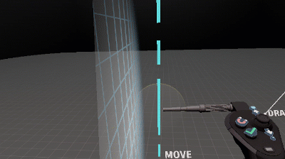

If you are using a tool that requires an axis, such as the Circle or Revolve tool, you can snap the axis to the symmetry plane.
To snap the tool axis to the symmetry plane, place it close to the plane until its color changes from teal-blue to magenta.
This indicates that the axis is snapped to the plane.
To lock the axis to a direction vector, position it until its changes color from magenta to red (X axis) blue (Y axis), or green (Z axis). Tap left or right on the tool hand analog stick (Oculus) or D-pad (VIVE) to cycle through X, Y, or Z placement of the axis.
