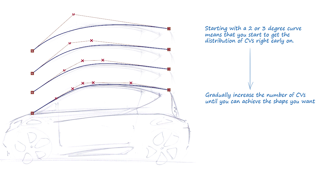

Applying the Rule
The easiest way to ensure a good flow of CVs is to start with a curve with very few CVs, for example a single-span degree 2 or 3. Try to match your design, and only increase the number of CVs gradually until you get just enough to achieve your desired shape.
