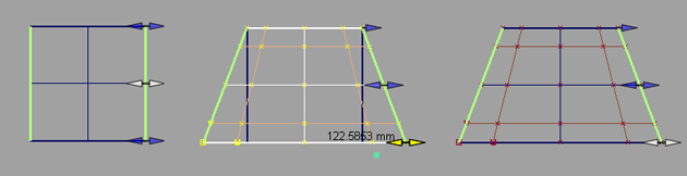

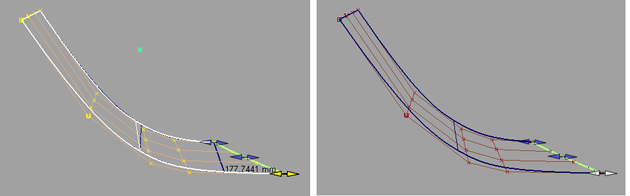

    • For a curve, drag the mouse to change the extend length.
    • For a surface, select the middle manipulator and drag to extend the surface proportionally. Or select one of the outer manipulators and drag to extend the surface non-proportionally.
    • Instead of dragging, you can type a distance and press . The distance is measured either in the current linear units, or as a percentage, depending on the Measurement setting in the Extend Object Options window.
    Note:
    Both ends must be extended in the same direction, either positive or negative. A label shows the extension distance while you’re dragging. The controls are turned on until you exit the tool.

    If using the Extrapolate type with Merge on, you can select two opposite edges of a surface and symmetrically extend both at the same time, as shown below.
    In all other cases, you can only use non-proportional Extend when a single edge is selected. Consequently it will not work when Chain Select is on and several tangent continuous edges are selected automatically.
  4. To snap to a curve, surface curve or trimmed edge while extending a surface, hold down the + keys and click down on the curve. Hold down to snap to a grid intersection, or to snap to a control point (CV, edit point).
    If extending curves, snapping to another curve will intersect the extended curve with the snap curve in the current view only.
