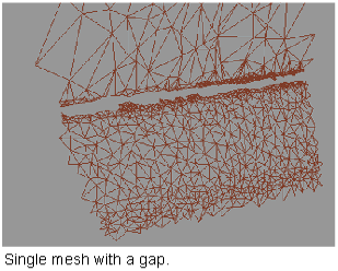

In the Mesh tool palette, click the Mesh Stitch tool
to seal gaps between the boundaries of components in a mesh. This tool works best to eliminate narrow gaps between boundaries. To fill larger openings, in the Mesh tool palette, select Mesh Cleanup, then click the Mesh Hole Fill tool
Build small “bridges” across gaps within a mesh, so that Mesh > Mesh Cleanup > Mesh Hole Fill
can be used to fill up the remaining holes.
