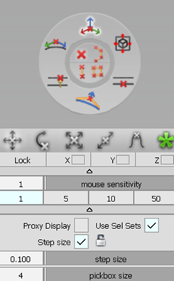

Hotspot interface
When the Transform CV tool is selected, holding down the space bar displays the hotspot interface under the cursor. Using this interface instead of accessing the options in the Control Panel reduces mouse movement when doing direct surface manipulation.
The transform tools are available in the horizontal ribbon, and the different modes that apply to the selected tool are displayed on the wheel. The center spot is divided into two halves: CV and Hull. The check box options appear on the sides, while the sliders and buttons are at the bottom. Roll-over an icon to see a description of what it does.
How to use the hotspot interface
  1. Choose the Transform CV tool in the Control Panel.
  2. Press and hold down the space bar.
    The hotspot interface appears
  3. Click on a tool (on the ribbon) to select it.
  4. Click on a mode (if available on the wheel) to select it.
  5. Click on the CV or Hull icon, depending on what you want to manipulate.
  6. Release the space bar.
    The hotspot interface disappears.
  7. Pick the CV(s) or hull(s) and drag. If the CVs are not visible, clicking on a curve or surface displays them.
    Note:
    If the CVs you want to transform are part of a selection set, turn on Use Sel Sets.
  8. To adjust the pick box size, or mouse sensitivity, hold down the space bar to bring back the hotspot interface, and adjust the sliders.
