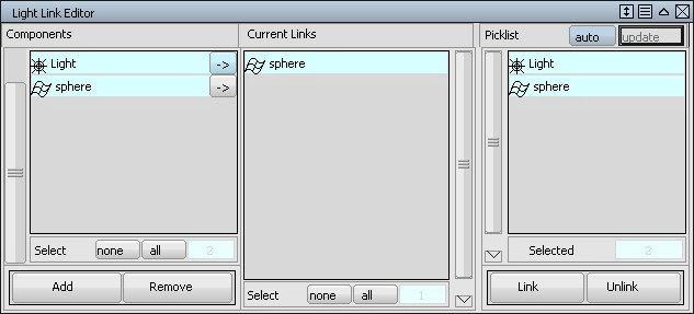

  1. Use Pick > Object to select the surface(s) and light(s) you want to link or unlink.
  2. Select Render > Editors > Light Links to open the Light Link Editor.
    All active lights and surfaces are listed in the Components list (at the lowest component level) and in the Picklist.
  3. Click the Link button to link the lights and surfaces listed in the Picklist.

  1. Use Pick > Object to select the linked surface(s) and light(s) you want to view.
    See Render > Editors > Light Links .
  3. Click the arrow (->) beside the surface or light in the Components list. All surfaces/lights linked to that light/surface are listed in the Current Links list.

  1. Use Pick > Object to select the linked surface(s) and light(s).
  3. Select the linked surfaces and lights in the Components list so they appear in the Picklist.
    See Unlink in Render > Editors > Light Links .
  4. Click the Unlink button.
