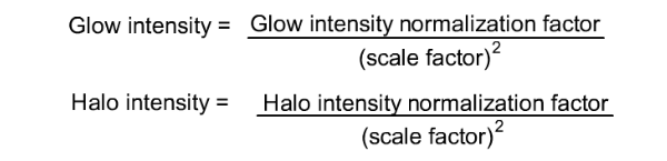

Render the animation with Auto ExposureON, and select a frame in which the shader glow brightness looks correct. Render that frame only, again with Auto ExposureON. Open the out file (out.log in the sdl folder), and find the Glow intensity normalization factor and the Halo intensity normalization factor. Enter these two values in the environment shader’s ShaderGlow Glow Intensity and Halo Intensity parameters, and set Auto ExposureOFF.
If you are also rendering at different resolutions, you must also scale these values based on the difference in resolutions (scale factor).
For example, if you are doubling the rendering resolution, the scale factor would be 2.
Alternatively, figure out the factor by which the *number* of pixels in the image increases, and multiply the glow by it.
that is: (1920 x 1280) / (720 x 486) = 7.023
Multiply your glow intensity by 7.023
