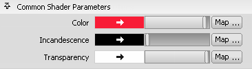

  1. Open the Control Window for the shader you want to copy parameter settings from (for example, Shader).
  2. Hold the key and click the shader swatch for the shader you want to copy parameter settings to (for example, Shader#2).
  3. In the Control Window, hold the key and click the names of the parameters you want to copy (for example, Color and Transparency). The parameter names become highlighted.
  4. Select Edit > Copy Parameters in the Multi-lister. The parameter settings are copied (from Shader to Shader#2).
  5. -click the parameter names again to deselect them.
