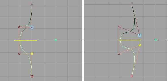

Moving the bottom CV automatically moves its symmetric twin (blue circle) in the opposite direction to maintain the symmetry.

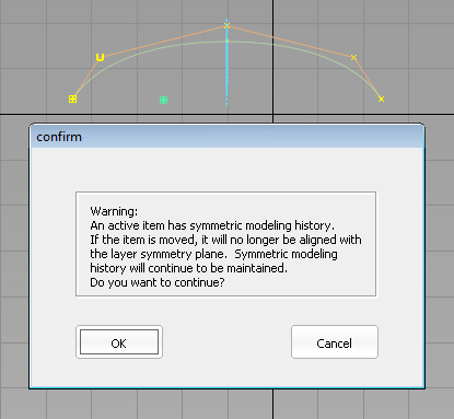

Once defined, the symmetry plane is unique to each curve or surface. When a curve or surface is transformed, its symmetry plane becomes decoupled from the layer symmetry plane, and follows the object. If the plane doesn’t match the layer symmetry plane anymore, it is drawn in a different color. A confirm box also appears in this case.
