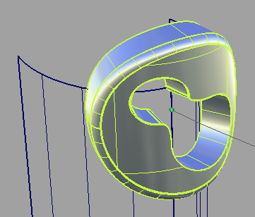

After you have finished setting up the Conform Rig, you will see something like the following screen shot (in this example, the target is the round feature on the right; the destination is the half-cylinder surface on the left). The conformed target is shown applied on the destination, and had been deformed to fit the shape of the destination.
A gray plane is drawn immediately below the original input target, which represents the reference plane. In the center of the reference plane an X marks the contact point with respect to the reference plane. On the destination surface, a green point represents the location of the same contact point after the conform has been applied. A gray curve shows how the contact point from the reference plane is placed onto the destination.
By default, the Conform Rig preserves the size and length of your targets, and also the shape of your targets. The Conform Rig is designed to retain the shape of the footprint. You can see in the previous screen shot that the top of the target has been stretched. Later we will discuss the option to change that.

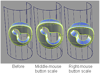

Use the Scale mode to adjust the size of the targets relative to the destination, using the contact point as the scale pivot. Again, if the target is scaled to extend beyond the destination, the tool extrapolates tangentially. Use the left mouse button to scale (click-drag to the left or right) the targets proportionally. Use the middle mouse to scale along the destination surface (making the target bigger but not thicker); use the right mouse button to scale how thick the target becomes.

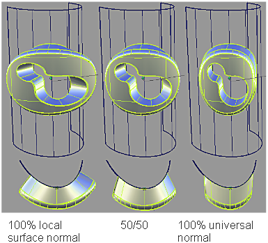

The surface on the right shows a tall version of the target, and also shows how conform works: by default, it uses the local surface normal to determine how to map the higher parts of the target, and for destinations that are very curved, this introduces distortions by stretching the top of the target because the normal directions diverge.
The Conform Control option window has a Parallel normal mode slider. If the value is 0.0 (as in the left objects of the next screenshot), you use 100% of the local normal of the destination. A value of 1.0 (on the right of the screenshot) means the normal of the destination found at the center of the target is used universally. The result is that the sides of the target appear parallel — hence the name. The default for this slider is 1.0. You can also use the slider to blend between the two effects (the middle objects in the screenshot use 0.5):

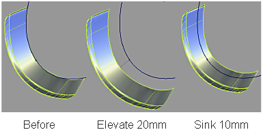

Use Elevate mode to choose to lift the targets up and away from the destination, or lower and sink the target into the surface. You can do so by click-dragging up and down in Elevate mode. You can also type in the elevation value in either absolute mode or relative mode, using the current linear unit.

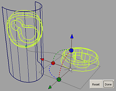

You can move the contact point. In the Conform Rig tool box, choose the Change Contact Point tool. After choosing this tool, you see something like the following:
Using the manipulator, you can move the contact point relative to the targets in their original position. As soon as you change the position of the contact point, the conformed targets update to show the effects of the change. You can also use the manipulator to snap the contact point to a particular point of the original target — click the light blue point at the center of the manipulator. After it turns white, you can use normal curve-snapping techniques to snap the contact point onto any part of the original targets, as shown here:
