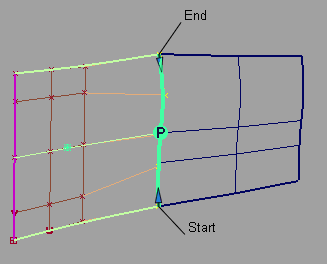

Partial
The Partial checkbox is always off by default when a surface is aligned. Initially, the input surface’s edges are aligned to the full extent of the master’s edge. If Partial is turned on, the closest points on the master surface’s edge (or curve) are used.
The Partial Join manipulators are always displayed. Use the manipulators (or the Partials sliders) to control the extent. The Partial option applies when a surface edge is aligned to another surface edge, isoparm, curve-on-surface, or free curve
Partial is turned off automatically if the manipulators are dragged to the ends of the master’s edge. It is turned on automatically when the manipulators are dragged away from the ends.
Turning on Partial always resets the manipulators to the closest points on the master’s edge. Conversely, turning off Partial sets the manipulators to the ends of the master's edge.

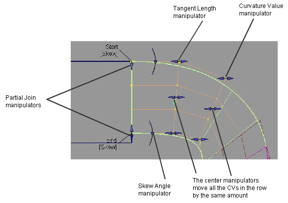

Outer Edge
The following section only appears when Alignment Type is Edge, and Continuity is set to G1 Tangent, G2 Curvature, or G3 Curvature.

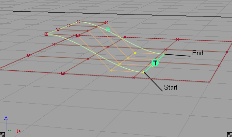

These options control the direction of the tangent (within the tangent plane) along the outer edges of the Input surface.
Align Start/End Together
When this box is checked, the setting for Start Align and End Align is kept the same.
Start Align/End Align
Edge Align – The edge is aligned to either the natural boundary or to a trimmed edge.
Skew – The edge is rotated by the specified Skew Angle while remaining in the tangent plane.
Click the label in the view window to toggle between Edge Align and Skew.
Start Skew Angle/End Skew Angle
The angle of rotation (in degrees) of the start or end outer edge.
These values can also be adjusted by using the small circle manipulators in the view windows.

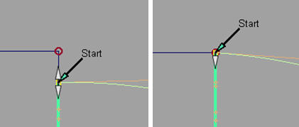

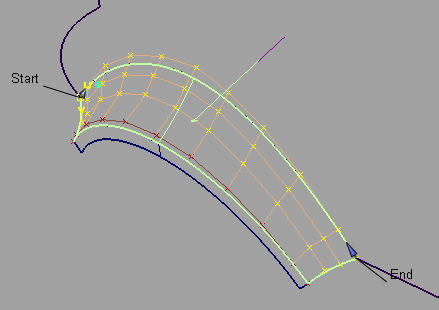

Partials
Start / End
These sliders values range from 0.0 to 1.0 and specify the percentage of the way that the start or end of the Input surface extends from the end of the Master surface (in parameter space).
These values can also be adjusted by using the Partial slider manipulators along the boundary. The manipulators indicate they have been positioned at the full extent of the edge of the Master by displaying only the internal arrow. Double arrows indicate that the Input edge is not positioned at the full extent of the edge of the Master.
The Partial slider manipulators also snap to the options set in the Snap Options window (except for Snap to Center and Pivot).

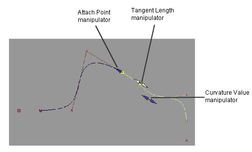

Attach Point
This section applies to curve alignment only.
Attach Point
Point on the Master curve that the Input curve is aligned to. The slider value ranges from 0.0 to 1.0 and specifies the percentage of the way from the start of the Master curve.

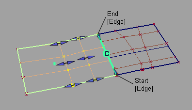

Using the manipulators
The manipulators appear as small arrows or double arrows, except for Skew which is an arc with a small circle. Once the manipulator is engaged by clicking the arrow or circle, mouse contact is not required to make further modifications.
The following values can be adjusted directly through manipulators:
Surface alignment manipulators
Curve alignment manipulators
