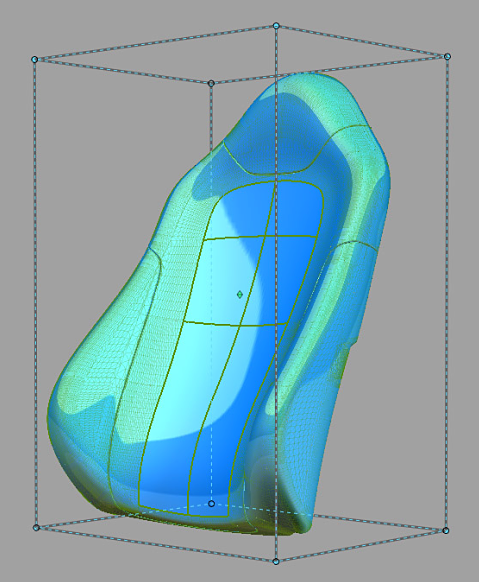

Alias provides a box-shaped manipulator called a lattice to enable global modifications to NURBS and subdivision models.
The lattice box always starts in disengaged mode, and is initialized as a bounding box enclosing the selected geometry.
The lattice can be modified and refined from its initial box shape without affecting the underlying targets (surfaces or meshes) as long as the lattice is disengaged. After developing a lattice that provides the shape and detail required, engage the lattice. Subsequent changes to the lattice will modify the targets.

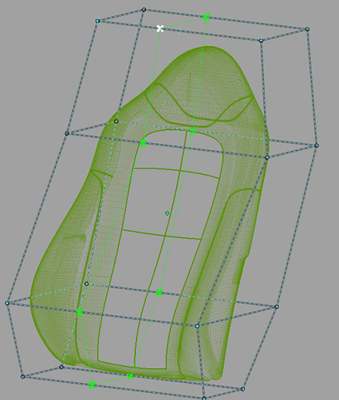

Alias provides a box-shaped manipulator called a lattice to enable global modifications to the model.
The geometry being modified is represented by a proxy. A proxy is a lightweight wireframe representation of the targets being deformed by an engaged lattice. The proxy interactively updates while you modify the engaged lattice to show what the targets look like after deformation (see the following image). Meanwhile, the targets remain unchanged until you release the mouse button (when Auto Update option is ON) or when you click GO (when Auto Update is OFF).

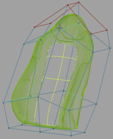

  5. When the lattice has the right shape, click the Toggle Lattice Engage State tool. The lattice box changes to solid lines in this mode.
    All modifications made to the engaged lattice influence the shape of the targets enclosed by the lattice.
    All the geometry not enclosed by the lattice are constrained. To show that these areas have been constrained, the lattice points and edges that intersect the geometry are shown in red.

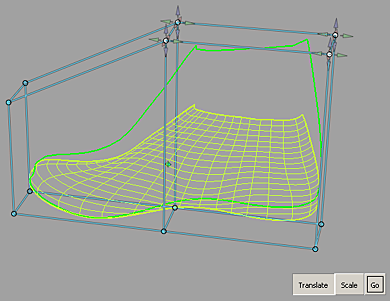

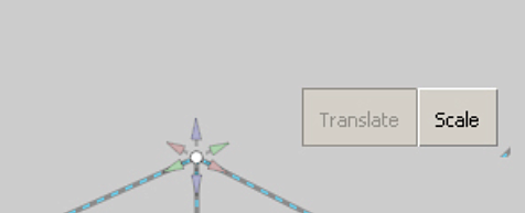

  6. Modify the lattice using the scale and translate manipulators.
