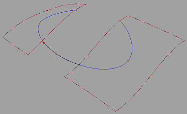

    The types of curves that can define a bend axis curve are:
    • free curves,
    • surface boundaries or isoparametric curves (isoparms)
    • trim curves-on-surface, or
    • parts of a trim-mesh (isoparms that have been truncated as part of a trim).
      You can even use curves that are created by increasing patch precision.
      Furthermore, you can use a sequence of curves that are continuous to define a single bend axis. The only requirement is that the curves form a sequence: each curve in the sequence should be positionally continuous to the previous one and the next one in the sequence. The curves need not be of the same type. As an example, the following image shows the combination of curves-on-surface and a free curve together to form a valid bend axis.

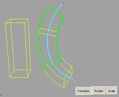

In the Bend Rig, you see something like the following screen shot. (In this example the target is a cube elongated along the z-axis direction, shown inside the tool with a pale green highlight, and the bend axis is a free curve with a cyan highlight):
Notice that by default, the Bend rig preserves the size and length of your targets. In this example, the bend axis is longer than the length of the target, so the bent cube only takes up part of the bend axis in the middle.

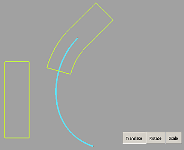

If there are parts of the target that extend beyond one or both ends of the bend axis, the tool extrapolates tangentially with respect to the bend axis.
To translate, click the Translate button and click-drag along the bend axis — the target follows. While dragging, a bright green outline can be seen (the proxy, which is a lightweight approximation of your target). The proxy allows for real-time interactive update. The targets update for real when you release the mouse button. You can also type in the translation in the current linear working units in either REL (relative) or ABS (absolute) mode. This is the absolute position of the contact point of the target on the curve.

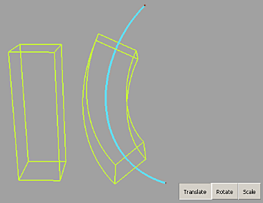

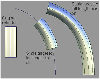

In scale mode, you can adjust the size of the targets relative to the bend axis. Again, if you managed to scale your target such that it extends beyond the bend axis, the tool extrapolates tangentially. If you use the left mouse button to scale (click-drag left or right), you scale the targets proportionally. If you use the middle mouse you scale only along the curve direction (making the target longer or shorter) and with the right mouse you can scale how “fat” the targets are.
Related to the scale mode is the option to Scale target to full axis length. If this option is on, the target is non-proportionally scaled so that its length matches that of the axis, while its girth is untouched.

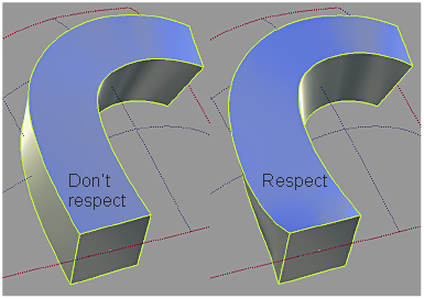

If you used as a bend curve a curve related to a surface, the Respect surface normal option may be of interest. When this option is On, in addition to the target following the shape of the curve after the tool is executed, the target also is twisted so that it follows the surface normals that are found along the specified bend axis. This option is not applicable if the bend axis is a free curve — an arbitrary orientation frame is chosen to minimize twisting of the target along the bend axis. If the option is off when using a surface-related curve as a bend axis, the tool treats the surface curve the same as a free curve.

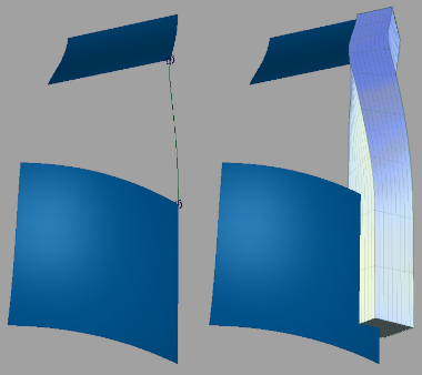

If the bend axis is a mixed-type, continuous sequence of curves, turning on the Respect surface normal option causes the targets to twist such that it interpolates the different surface normals in the sequence of curves in the axis, as shown here:
On the left, you can see that original set-up for the bend axis — two surface boundaries with a blend curve between. The two surfaces have very different normal directions. On the right, you see that an elongated cube bent onto this axis twists to accommodate the surface normal direction when the Respect surface normal option is turned on.
Generally, an appropriate length of the axis is chosen to reflect the length of the target; this option stretches or compresses the length of the target to be the same length as the axis.
