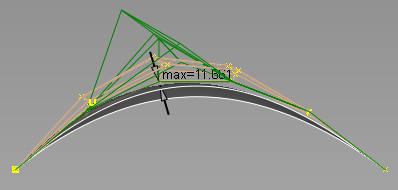

Check Deviation
Displays and updates the maximum deviation between the input and smoothed object after each Smooth.
Proxy Display
Displays the original input.
