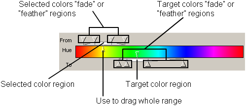

  3. Move sliders to select a range. The upper sliders select the color range on the original image. The lower sliders select the target color range.
    Select a range on the original image using either the eye droppers or by dragging the sliders on one of the three bars (Hue, Saturation, or Value). The sliders offer the ability to fine-tune the edges of the selection as well as the ability to move the whole range without affecting the size of the range.
