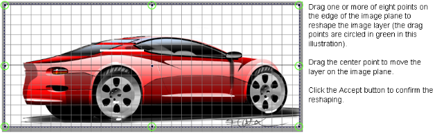

Paint Edit > Deform Layer
Warps and deforms an image by moving the four corners and sides.

Image Deform operations can be undone using the standard Edit > Undo menu item.
When Image Deform is selected, the options are added to the Paint panel.
All Alias snap modes (grid, point, and curve) work with image deformation, allowing the manipulator handles to be snapped to geometry.
