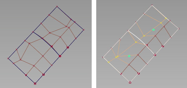

Plane
View based – The plane is calculated from the view vector (perpendicular to the active window) and the vector joining the end CVs of the row.
Best fit – The plane is chosen as the one that best fits the set of CVs (similar to a least-square fitting) while going through both end CVs.

Include Edges
If this option is checked, the first and last row of CVs (in U and/or V) are also planarized. The corresponding surface edges appear as straight lines on the planes of projection.

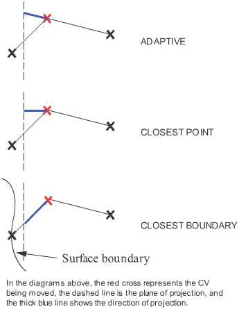

Project Vector
This option determines the direction of projection for each CV.
Adaptive – The direction of projection is along the hull line that is closest to the perpendicular of the plane.
Closest point – The direction of projection is perpendicular to the plane.
Closest boundary – The direction of projection is along the hull line toward the closest surface boundary.
