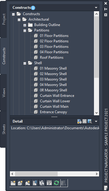

All drawings in the project are displayed and organized in the Project Navigator.
Project Navigator in AutoCAD Architecture 2023 Toolset

Constructs
Constructs contain the geometry representing the building. They are drawing files containing one unique constructed part of the building. Each floor should be represented by at least one construct. If the building is large and complex, each floor can be created from multiple constructs, like one construct for the wall layout, one for the cubicles and furniture, and one for the framing elements.

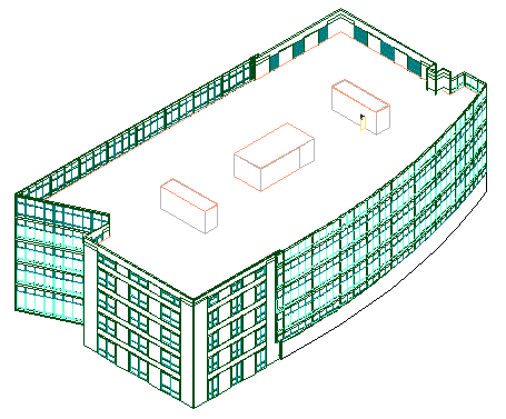

Views are drawings assembled of a number of constructs to represent one specific view of the building. For example, you can create a view drawing for a single floor, containing the constructs for the walls, the furniture, and the framing. Another view drawing could contain the entire building model with all floors in a 3D view. There are also specialized view drawings for details, sections, and elevations.
3D view of entire building
