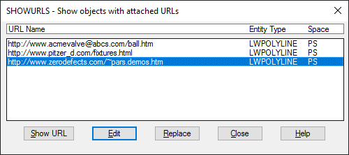

Displays all attached URLs contained in a drawing, and allows them to edited.
Enter SHOWURLS to display the Showurls dialog box. You can click a single URL to display it, or you can click one or more URLs to edit or replace them.
| Show URL | Temporarily hides the Showurls dialog box to display the area or objects associated with the URL. |
| Edit | Allows the attached URL to be edited. A common editing operation can be performed on multiple selected URLs. |
| Replace | Allows the attached URLs to be edited using the Find and Replace dialog box. |
