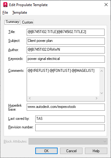

Editing the Propulate TemplatePropulate uses a template file to determine what values should be inserted into the Drawing Property fields of a drawing. The template file must be edited before using it to specify what and where values are applied to the Drawing Properties dialog box. You can create as many different templates as you need, however there is only one active template at a time. The default template file name is template.prp. The easiest way to edit an existing template or create a new one is to use the Edit Propulate Template dialog box.

To edit the template file, enter text or one of the special insert options in the appropriate field. For example, entering Downtown Renovation in the Subject field would insert the string Downtown Renovation into the subject field of the Drawing Properties dialog box for each drawing processed with this template. In addition to literal strings like this, there are four special commands that can be used to extract drawing specific information and insert that data into the Drawing Properties dialog box.
| @[block.attributeTag] | Extracts the attribute tag value from an attributed block and inserts it in the specified field.For example: inserting @[title.drawnby] in the Author field causes Propulate to search the drawing for an attributed block named title, extract the value of the drawnby attribute field, and insert that value in the Author field of the drawing's Drawing Properties dialog box. If common blocks are used across a project it is a simple matter to update a large number of drawings to reflect their specific attribute values. |

Example: Entering @[XREFLIST] @[FONTLIST] @[IMAGELIST] in the Comments field could produce the following:
Xrefs: A d:\xrefs\1a6 A d:\xrefs\2a6 A g:\project\work\3a6 Fonts: G:\ACAD2021\support\simplex.shx G:\ACAD2021\fonts\txt.shx G:\ACAD2021\fonts\ROMANS.shx Images: G:\Acad2021\acadsig.jpg
