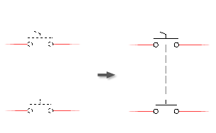

Links selected related components with a dashed line.
The TAG, description, and cross-referencing attributes of the second through last components you select for linking become invisible. The Unhide Attribute command turns the visibility of the selected attributes back on. Components must have X?LINK attributes to link.
