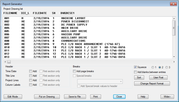

Extracts the settings of each drawing in the project and displays in a report.
Click
. Find
- (Optional) Select folders in Project Manager.
- Right-click the project or folder name, and select Drawing List Report.
- (Optional) In the Drawing List Report dialog box, click Format and browse to a report format file.
- Click New Report.
- Select the drawings to process.
Note: Folders selected in Project Manager are preselected in the Select Drawings to Process dialog box.
- Click OK.
- Do any of the following:
- Change the report format
- Save to a file
- Place the report as a table
- Print
