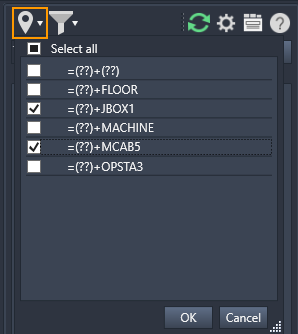

Filter components in your component tree view based on location and installation values.
Click
. Find
In the Project Manager, click the Location View tab.
- In the Location View, click Filter by Installation and Location
- Clear Select All, and select the values you want to show in your component tree view.
Note: If the AutoCAD Electrical toolset project is not linked to an Inventor project, the Location View buttons do not match the image shown.
- Click OK.
