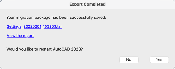

Transfer settings from one machine to another. Settings can include user profile, toolbar and toolset customizations, command aliases, plot settings, templates, and the My Properties settings for the Property palette.
The Export Settings dialog box displays.
You are prompted to save any unsaved drawings and then AutoCAD closes.
The dialog box displays.

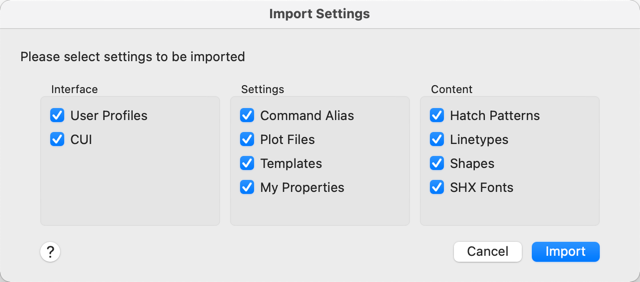

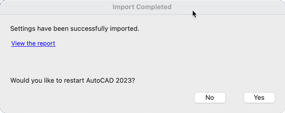

The Import Settings dialog box displays.

The utility creates a zip file containing the exported custom settings and files which you can then import on another machine. Each machine must be running the same version of AutoCAD or AutoCAD LT.
Follow these steps to import the custom settings and files after exporting them to a zip file.
Applications
Utilities
Terminal.
./AdMigrator -i -s {zip file path and name}.tar.gz
./AdMigrator -i cui {zip file path and name}.tar.gz
