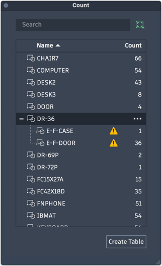

| Displays the count criteria including the general properties of the counted objects and any user-defined block attributes and parameters. |
| Displays the count criteria including the general properties, user-defined block attributes and parameters, and the issue report of the counted objects. Issues can include overlapping, exploded, or renamed objects. |
Count all blocks
The Count palette displays the number of instances of each block on the drawing.

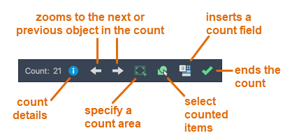

Count objects within an area
All instances that match the selected objects are highlighted in the drawing.

COUNT - Counts and highlights the instances of the selected object in the drawing.
COUNTAREA - Defines the area to count the instances of an object or block.
COUNTAREACLOSE - Cancels the count selection area.
COUNTCLOSE - Closes the Count toolbar and exits the count.

COUNTNAVNEXT - Zooms to the next object in the count result.
COUNTNAVPREV - Zooms to the previous object in the count result.
