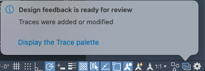

When you open a drawing containing a trace, you'll see an alert.

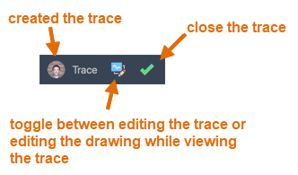

While a trace is active, the Trace visor is available.
- edit mode is active, click to switch to view mode
- view mode is active, click to switch to edit mode

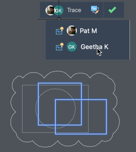

Now that multiple people can contribute to a trace, click the avatar on the trace visor to display the list of contributors for the active trace.

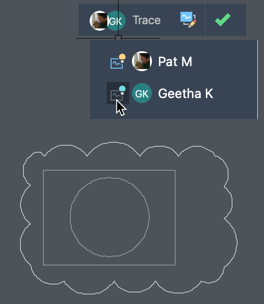

If there are contributions from others, you can do the following:
Hover over a trace object to see who added it to the trace.

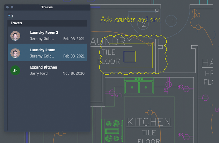

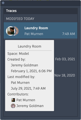

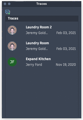

TRACEPALETTEOPEN - Opens the Trace palette where you can view and manage traces in the current drawing.
