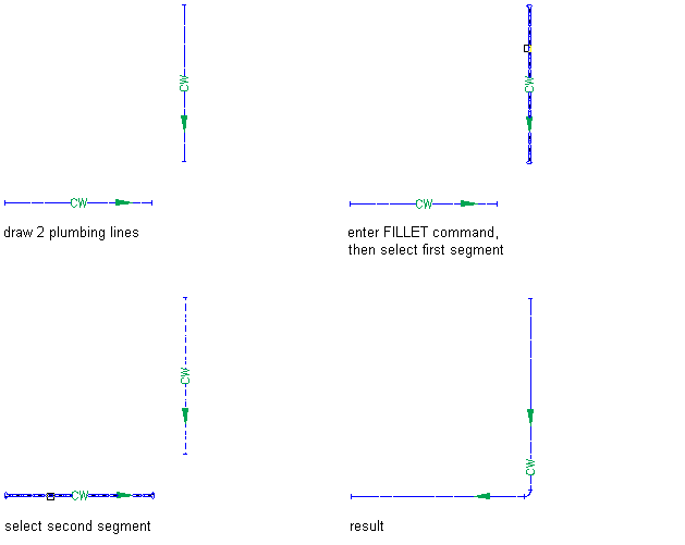

In AutoCAD MEP 2023 toolset , you can use FILLET to fillet not only AutoCAD objects, such as lines, polylines, and arcs, but also schematic lines and plumbing lines. By using FILLET with a fillet radius of zero (default), you can easily connect schematic lines or plumbing lines by extending or trimming them. You can use the command in orthographic mode or isometric mode.
Filleting plumbing lines
