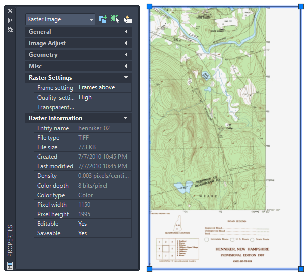

  1. In the ..\Program Files\Autodesk\ApplicationPlugins\RasterDesign2023.Bundle\Contents\Tutorials\Tutorial5 folder, open the drawing file Map_08.dwg.
  2. Select the image frame of the USGS quad sheet.
  3. Right-click and select Properties to display the Properties palette.
    The Properties palette contains a long list of properties; use the vertical slider to scroll up and down.
    Specify the background transparency properties for the image
  4. Under Misc, click Background Transparency and change the value to Yes.

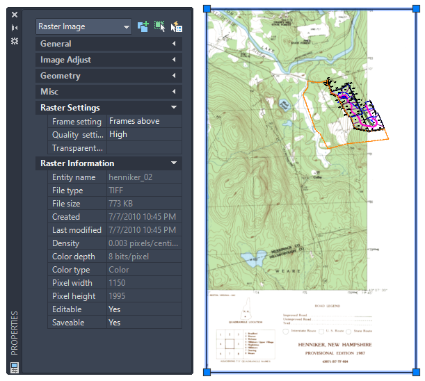

  5. Under Raster Settings, click Transparent Color, then click the pick button [...] to display the Transparent Color dialog box.
  6. Click Select, click anywhere in the white border area of the USGS image, then click OK.
    Note that the white border becomes transparent, along with any white areas within the map.
  7. Close the Properties palette.
