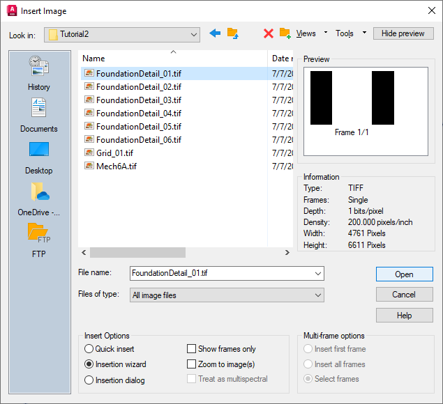

  2. To display the Insert Image dialog box, on the ribbon, click Raster Tools tab Insert & Write panel Insert .
  3. In the Insert Image dialog box, from the Files of Type list, select All Image Files.
  4. If necessary, navigate to the ..\Program Files\Autodesk\ApplicationPlugins\RasterDesign2023.Bundle\Contents\Tutorials\Tutorial2 folder.
  5. Select the image file FoundationDetail_01.tif.
  6. Review the values shown for each parameter in the Information box.
    This parameter list identifies important characteristics of the image.
    The scanned drawing in the image is turned on its side (portrait orientation). In addition, the image, which was scanned from a blueprint, has a light background with line work that is difficult to see.
    The values for Depth and Density are important for this image:
    • The depth of 1 bit per pixel indicates a bitonal image.
    • The density of 200 dots per inch (dpi) indicates that the image was scanned at a low resolution. This low-quality scan may be responsible for some of the problems with this image that you correct in later exercises.
