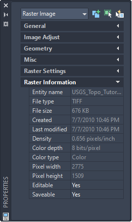

  4. Right-click and choose Properties to display the Properties palette.
  5. Scroll to the end of the properties list.
    This example shows the appearance of the Properties palette when a Raster Image is selected. The image data appears at the end of the properties list in the Raster Information section.
  6. View the edit status of an image
  7. Click the Editable row, then click at the end of the row.
    The Edit Status dialog box indicates that this image can be edited and saved. When an image cannot be edited or saved, you can open the Edit Status dialog box to determine why.
