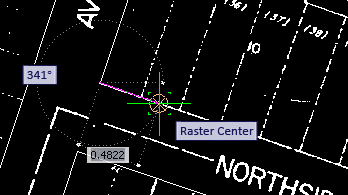

  18. Move the cursor to the west edge of Elmhurst Avenue, and snap to the center of the raster line. You should see the Raster Snap symbol and Raster Center tooltip to confirm this.
  19. Move the cursor where the road intersects the cul-de-sac and click to snap to the center of the raster line.
    Tooltips show the line length and angle (252 degrees).

  36. Click the end of the vector line at the corner of Elmhurst and Northside, and move the cursor a short distance east along Northside.
    Notice that when you have two numeric prompts, such as angle and length, one of them is highlighted, indicating that you can enter a numeric value.
  37. Press the Tab key to switch the highlight from angle to length several times, then stop on angle.
  38. Enter 342, which is 90 degrees from the angle of Elmhurst (252 degrees), then press Tab to switch the highlight to the length value.
    Now the angle is locked at 342.
  39. Slide the cursor east to the edge of Oak Place, click on the raster street edge, then follow this edge north east toward the cul-de-sac.
  40. At the Raster Corner prompt, click once to mark the endpoint, then right-click and click Enter.
