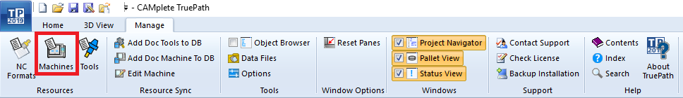

  1. Start TruePath.

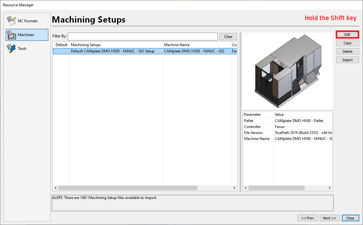

  2. In the ribbon, go to Manage > Resources > Machines.
  3. Select your machine.
  4. Click Edit.

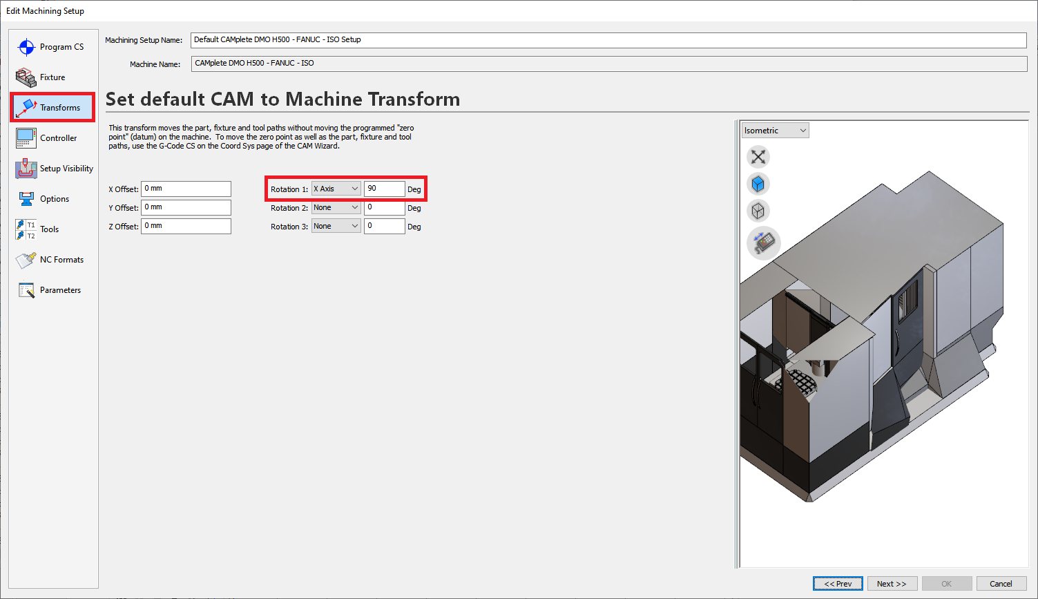

  5. Click Transforms.
  6. Set the Rotation 1 drop down to X axis and set the value to 90.
  7. Click OK.
  8. Click Close.
