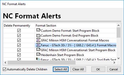

At this point, the main format will be deleted from the tree. However, the sub-sections of the format have not been because they could potentially have been shared by other formats. Click Analyze to find any of these un-used sections.
The NC Format Alerts dialog will be displayed with any NC format sub-sections that do not currently belong to an NC format.
Click Select All to make sure all items are selected for deletion:
Make sure that Automatically Delete Children is checked ON.
Click OK and the orphaned sub-sections will be permanently deleted.
If you click Analyze again, no sub-sections will be found:

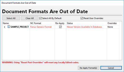

When you make changes to the NC Format in the NC Format editor, you can re-apply those changes to programs in existing projects (that use the edited format).
When you close the NC Format manager and you have a document loaded, you will be prompted to re-apply the format:
The dialog will list any programs in the grid that used the edited format.
Name – The name of the program.
NC Format – The name of the NC Format.
Re-Apply – Check this option ON to re-apply the format.
Status – Show the status of the format. If the database NC Format is newer than the document format, this will say New Version Available In Database.
Overrides – Shows any local edits that were made to the program. This might be changes to the tilt preference and other options that the NC Format controls.
Select All – Will select all programs in the grid for re-application of the NC Format.
Clear All – Will de-select all programs in the grid.
Select All By Default – Controls whether all out-of-date programs will be selected for re-application by default
Reset User Overrides – Will reset any user initiated overrides (see the overrides column). When this option is checked, anything that was overridden by the user will be restored to the NC Format settings.
Re-Apply Format(s) – Click this to re-apply the NC Format to the selected program(s).
Cancel – Close the dialog without re-applying the NC Format.
Select the programs for re-application and click Re-Apply Format(s).
The NC Format will be re-applied and the program will be regenerated.
The NC Format can be forced to be re-applied by clicking Re-Apply NC Formats on the Programs tab of the Ribbon. This will show the Re-Apply NC Formats dialog:
This dialog functions the same as Documents Are Out Of Date dialog. Note that is your format is up-to-date, the Status will be listed as OK.
