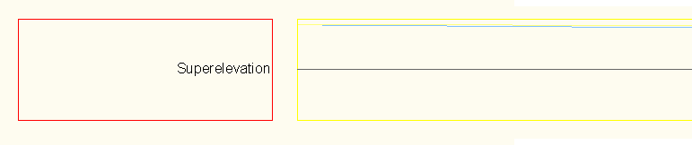

This sample demonstrates the creation of a data band style displaying the slopes of the outside shoulders - the right shoulder in yellow and the left in blue. A gray reference line is also added.

This style produces a data band that looks like this:
