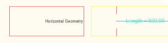

This sample demonstrates the creation of a data band style displaying information about alignment geometry with a title:

This style produces a data band that looks like this:
