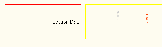

This sample demonstrates the creation of a data band style displaying section elevation data at two different locations:

This style produces a data band that looks like this:
