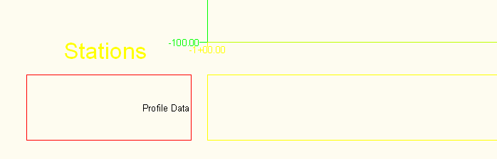

This sample demonstrates the creation of a data band style displaying section elevation data at two different locations:
Dim oBandProfileDataStyle As AeccBandProfileDataStyle
Set oBandProfileDataStyle = oDocument.ProfileViewBandStyles _
.ProfileDataBandStyles.Add("Profile Band")
With oBandProfileDataStyle
' Add ticks and labels to each horizontal
' geography location.
.HGPLabelDisplayStylePlan.Visible = True
.HGPTickDisplayStylePlan.Color = 10 ' red
.HGPTickDisplayStylePlan.Visible = True
.HGPLabelStyle.TextComponents.Item(0).Contents = _
"<[Station Value(Uft|FS|P0|RN|AP|Sn|TP|B2|EN|W0|OF)]>"
.HGPLabelStyle.TextComponents.Item(0).Color = 11 ' red
.HGPLabelStyle.TextComponents.Item(0).Visibility = True
' Modify how the title is displayed.
.TitleBoxDisplayStylePlan.Color = 10 ' red
.TitleBoxDisplayStylePlan.Linetype = "DOT"
.TitleBoxDisplayStylePlan.Visible = True
.TitleBoxTextDisplayStylePlan.Color = 80 ' green
.TitleBoxTextDisplayStylePlan.Visible = True
.TitleStyle.Text = "Profile Info"
.TitleStyle.TextHeight = 1.0
.TitleStyle.TextBoxWidth = 2.0
' Hide the rest of the information locations.
.VGPLabelStyle.TextComponents.Item(0).Visibility = False
.MajorIncrementLabelStyle.TextComponents.Item(0). _
Visibility = False
.MajorStationLabelDisplayStylePlan.Visible = False
.MajorTickDisplayStylePlan.Visible = False
.MinorIncrementLabelStyle.TextComponents.Item(0). _
Visibility = False
.MinorStationLabelDisplayStylePlan.Visible = False
.MinorTickDisplayStylePlan.Visible = False
.VGPLabelDisplayStylePlan.Visible = False
.VGPTickDisplayStylePlan.Visible = False
.StationEquationLabelStyle.TextComponents.Item(0). _
Visibility = False
.StationEquationLabelDisplayStylePlan.Visible = True
.StationEquationTickDisplayStylePlan.Visible = True
End With
This style produces a data band that looks like this:
