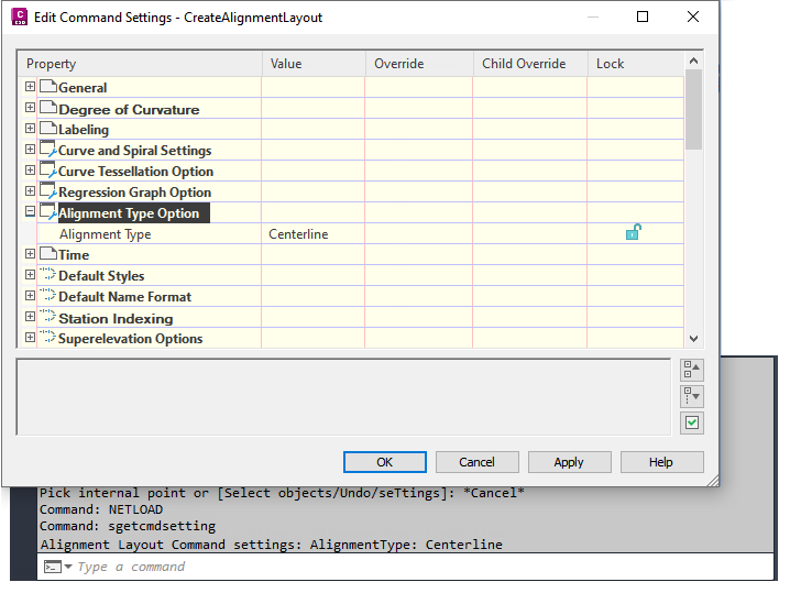

The command settings apply to commands, and correspond to the settings in the Commands folder for each item in the Autodesk Civil 3DToolspace Settings Tab. Each command setting has a corresponding class named SettingsCmdCommandName. For example, the settings class corresponding to the CreateAlignmentLayout command is SettingsCmdCreateAlignmentLayout. As with other types of settings, you use the CivilDocument.Settings.GetSettings() method to access command settings objects in the document.
The following snippet determines what the “Alignment Type Option” is for the CreateAlignmentLayout command:
SettingsCmdCreateAlignmentLayout alignLayoutCmdSettings = doc.Settings.GetSettings<SettingsCmdCreateAlignmentLayout>();
ed.WriteMessage(@"Alignment Layout Command settings: AlignmentType: {0} ",
alignLayoutCmdSettings.AlignmentTypeOption.AlignmentType.Value
The result of this code returns the current command setting:
Getting command settings
