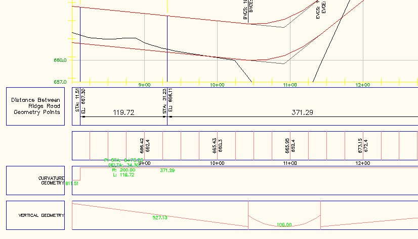

Data bands are a way to display more information with profile views and section views, including differences between sections, profile geometry, and superelevation along an alignment. Data bands consist of one or more strips at the top or bottom of each graph with tick marks, graphics, and labels describing particular features of the subject of the graph.
The bottom of a profile view with four data bands
