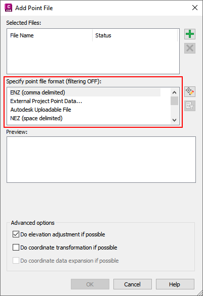

// get the point file format object, required for import:
PointFileFormatCollection ptFileFormats = PointFileFormatCollection.GetPointFileFormats(HostApplicationServices.WorkingDatabase);
ObjectId ptFormatId = ptFileFormats["PENZD (space delimited)"];
oSurface.PointFilesDefinition.AddPointFile(penzdFile, ptFormatId);
