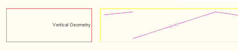

This sample demonstrates the creation of a data band style displaying the direction of slope for all segments of a profile with a title:

This style produces a data band that looks like this:
