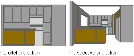

The difference between perspective views and parallel projections is that perspective views require a distance between a theoretical camera and target point. Small distances produce severe perspective effects; large distances produce mild effects.
The following illustration shows the same model in both a parallel projection and perspective projection. Both are based on the same viewing direction.
