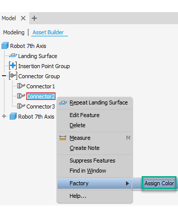

Assign a color
  1. In the Inventor Model browser, right click on the connector to expose a list of context menu options.
  2. Expand the Factory menu options and select Assign Color.
    custom connector color
  3. Select a color from the Color palette to assign to your connector. The default connector color is green.
    color palette
  4. Click OK.
  5. Save to publish the asset to the Asset Browser.
  6. To delete a connector, right click on the connector in the Inventor Model browser and select Delete from the context menu.

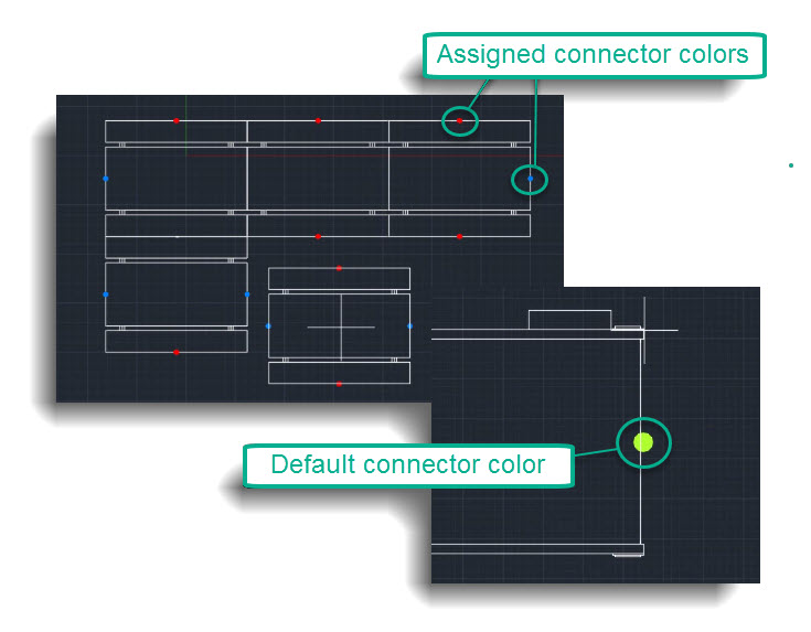

Tip: You can also assign a custom color to multiple connectors at once by holding down the Ctrl key and selecting the connectors you would like to assign a color to. Once the connectors are selected, choose a color from the Color palette to assign that color to all selected connectors.
Customized connector colors persist throughout future sessions. In AutoCAD Factory, these custom asset connector colors display when you go to place or connect the asset in your layout.
connector colors

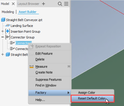

Reset Connector Color
In order to restore a connector to universal green color, you don't have to go back inside the color selection dialog to pick the correct green color. Instead, you can reset it to the default color in the context menu.
  2. Expand the Factory menu options and select Reset Default Color.
    reset default color
