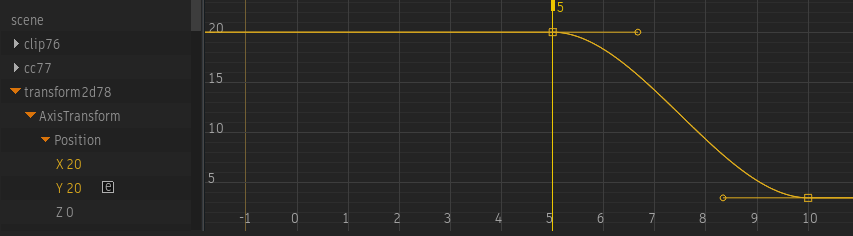

  2. Right-click the source channel and select Copy Channel.
    For example, copy the x position of the AxisTransform of a 2D transform.
  3. Right-click the destination channel and select Link Channel.
    To link the y position to the x position, you right-click the y axis and select Link Channel, with the result of y following exactly the x values.
