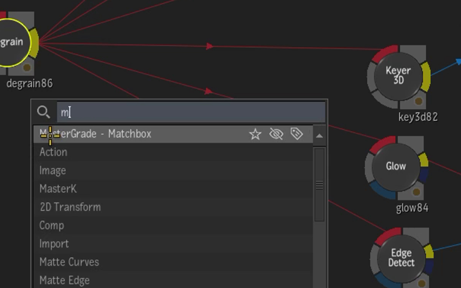

To add a node to a Selective:
The MasterGrade Matchbox is now available under the Selective.

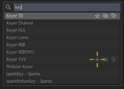

Every time you add a node with Search, Flame notices how often you use it. Search sees the tools you use and automatically displays the most used tools at the top.
So if you add the same node a few times, it starts appearing at the top of the search list. This is dynamic and will change the more you use Flame.

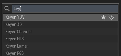

But you can also ensure that you favourite tools always make it to the top of Search results by making them your favourites.
To favourite a tool:
Next time you display Search, Keyer YUV appears at the top of the search results.

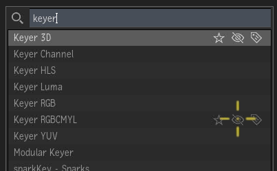

Chances are that you don't always need access to every single tool available to you. Maybe the Keyer RGBCMYL is not for you, or you only want to use the GMask Tracer and hide the legacy GMask tool.
This is why you can hide tools from Search results.
To hide a tool from the Search results:
The Keyer RGBCMYL will no longer appear in any Search results.

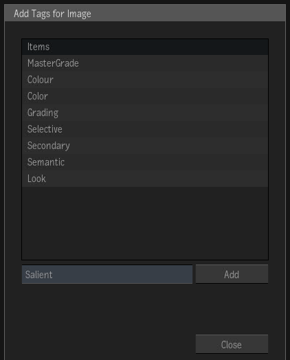

You can add, rename, and remove tags from the Preferences. If a tool is not displayed in the Tags list, you must first add a tag from Search results.
To add a tag to a tool directly from Search:
From now on, searching for Salient displays Image tool as a top result.
