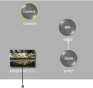

- Drag the Projector node from the node bin and place it in the schematic.
- Drag the Projector node from the node bin and place it where you want it in Result view.
- Double-click the Projector node. You do not need to be in Schematic view to add a node in this manner.

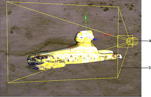

The Projector node appears in the schematic and a projector icon appears in the scene.
(a) Projector node
- Double-click the Projector node to display the Projector menu, or follow the tab population rules for the Object menu (see
Populating Menu Tabs of Selected Objects).
The Projector is selected.
- Switch to Camera view to manipulate the projector in the scene using the View box.
(a) Projector icon (b) Yellow outline shows the projector field of view
