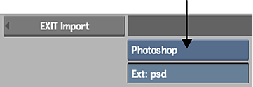

To import a PSD file into Action:
- From the Action Node bin, double-click the Import node.
The file browser appears.
- From the Import Type box, select the Photoshop format.
- Select a
.psd format file.
- Click Load.
The Photoshop file is loaded into Action. Each layer is parented by an axis, and blend modes are maintained.
A Batch reel is created to house the images imported in the layers. It is closed by default.
