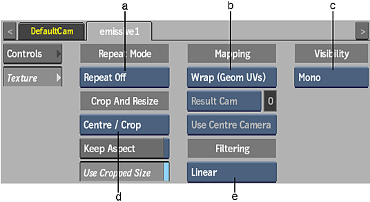

The Emissive menu is divided into two tabbed sections: Controls and Texture.
(a) Repeat Mode box (b) Mapping box (c) Camera Type box (d) Fit Method box (e) Filter box
