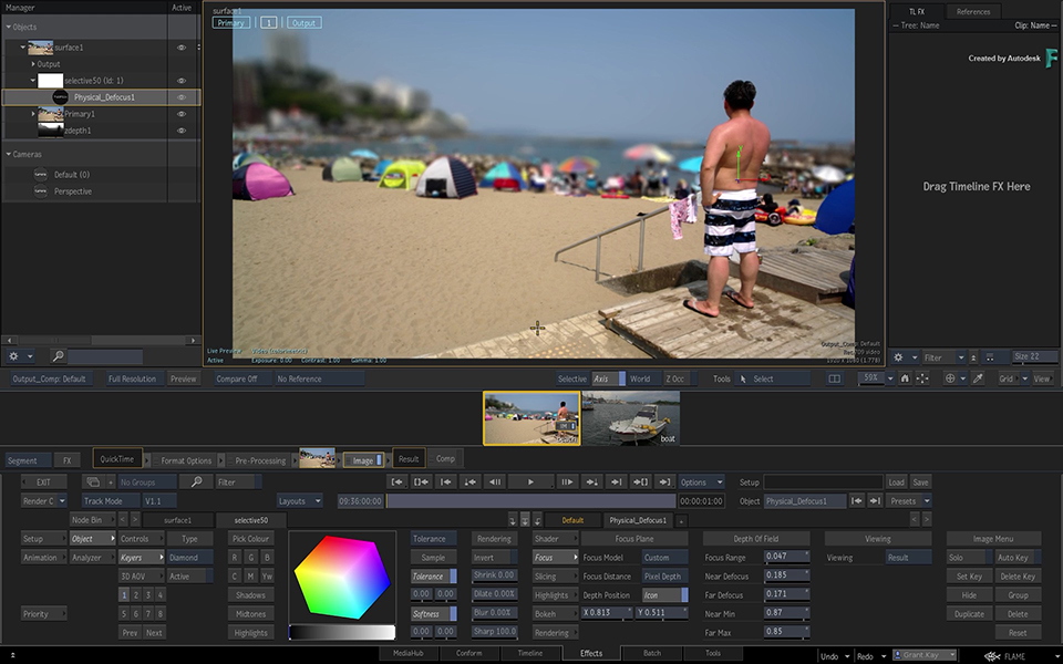

The PhysicalDefocus matchbox completes the previously released Physical Bokeh and Convolve by adding depth support to the same convolution engine.
This node offers two independent Defocus model: a custom one and a physical. The node also offers different ways to set the focus plane, as well as leverages the Action Camera value. Finally, you can use its procedural kernel for the bokeh, provide your custom kernel, or use the PhysicalLensKernel matchbox.

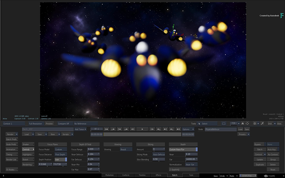

Depth
Physical Defocus requires a normalized depth ranging, where values range from 0.0 to 1.0. A Depth render pass from a renderer other than Action is probably expressed in absolute unit values, and needs to be normalized. Use the Depth controls to normalize the Depth map.
- Custom Near/Far
- By default, the Near and Far values of the current Camera are used when the effect is used in Action. If they do not match the Depth data, you override it by manually entering the near and far depth values.
You can improve the precision by entering the camera data that was used when the scene was rendered. If that information is missing, use the colour picker and pick the pixels of the Z-Depth map to find the smallest and largest depth values. Enter these values as the Near (smallest) and the Far (largest) values.
- Normalization
None: The default option. If you are using the Z-Depth render pass generated by the Action node or any other renderer generating normalized depth, use None: it does not apply any normalization.
Inverse: Use if the renderer creates a normalized inverse depth where a white value of 1.0 represents the closest distance to the camera and black at 0.0 the farthest distance from the camera.
Near-Far: The renderer outputs a Z-Depth expressed in units from the point of view of the camera. This type of Z-Depth map always appears as white frames: 1.0 represents a single unit of distance from the camera. Use the Near/Far fields below to match as closely as possible the depth range to maximize the depth precision. This is the type of Z data generated by the Arnold renderer.
Far-Near: The inverse of the Near-Far option.
Min-Max: Automatically map the minimum and maximum colour values to the normalized 0.0-1.0 range. However, this mapping is done for every frame and can lead to discrepancies in the Focus Plane between frames. If you use this option you might have to animate the Focus Plane.
Max-Min: The inverse of the Min-Max option.
- Z-Depth HQ
- Z-Depth is much more precise in 32-bit precision. If for performance reasons you do not want to switch to 32-bit Action Rendering, enable Z-Depth HQ Action output pass instead, which is encoding 32-bit precision in 16-bit file format.

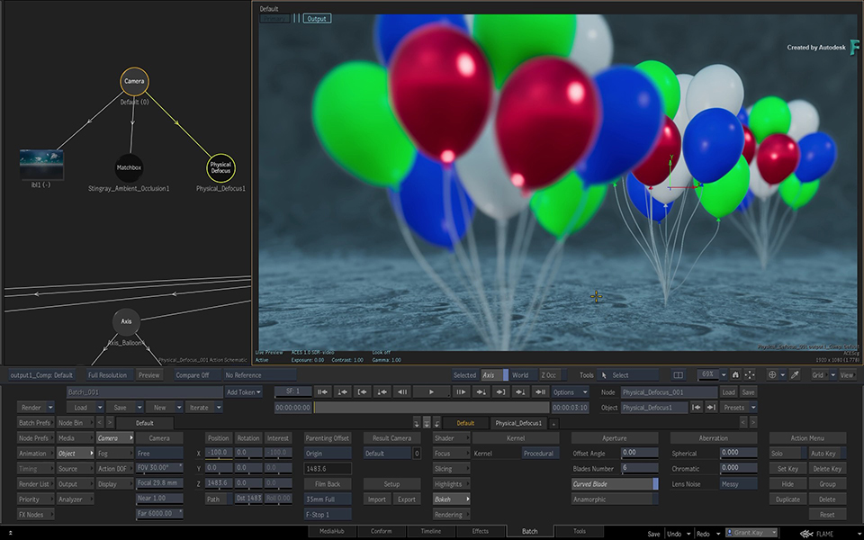

Bokeh
Kernel
You can use the included Procedural kernel generator or the Kernel input. Keep in mind that the larger the input size, the longer the rendering time. A kernels size is usually in the range of 300x300 pixels. If you're using the Input option, make sure to connect a kernel image to the Kernel input of the PhysicalDefocus node. Connect the PhysicalLensKernel matchbox to access a wide array of kernels.
Aperture
Aperture settings are only available when
Kernel is set to
Procedural.
- Offset Angle
- Rotate the bokeh kernel.
- Blades Number
- The number of blades. Impacts the shape of the kernel.
- Curved Blade
- Curve the shape of the blades. Impacts the shape of the kernel.
- Anamorphic
- Makes the bokeh an anamorphic effect with a 2:1 ratio.
